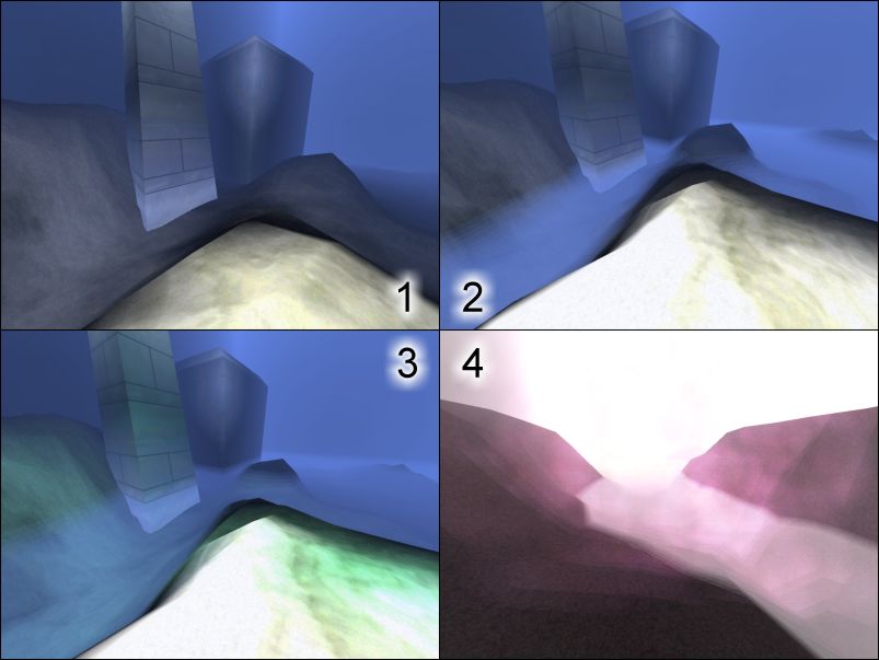

![]() About Fog Planes Now, you too can enjoy fog planes without expensive fog makers or messy buckets of dry ice. The images above show the following: 1) A scene with standard A6 fog 2) Fog planes added along ground level 3) Lighting added to accentuate the effect 4) Another scene with a thin series of fog planes This is a pretty simple effect you can achieve by creating a series of semi-transparent discs that follow the player around. Tutorial 1) Grab the disk model. This MDL is just a flat, wide disk. 2) Add the Fog Plane Generator entity to your script:
